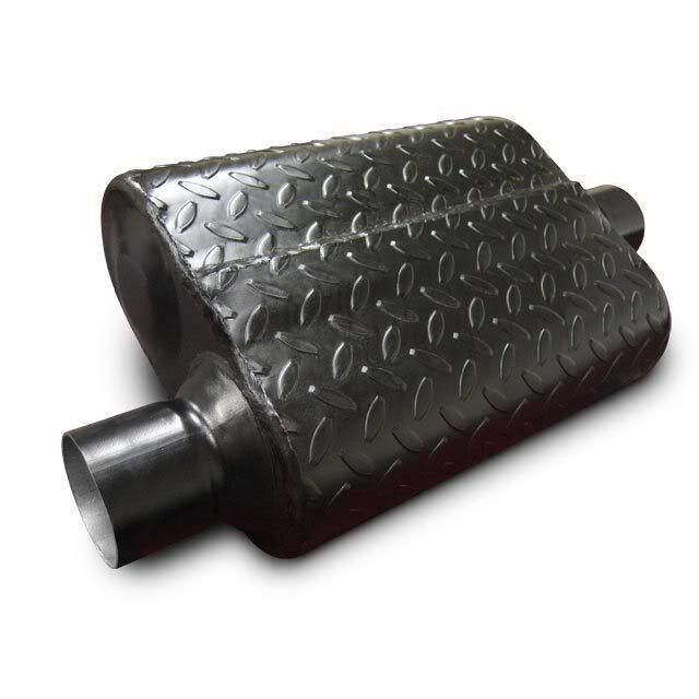

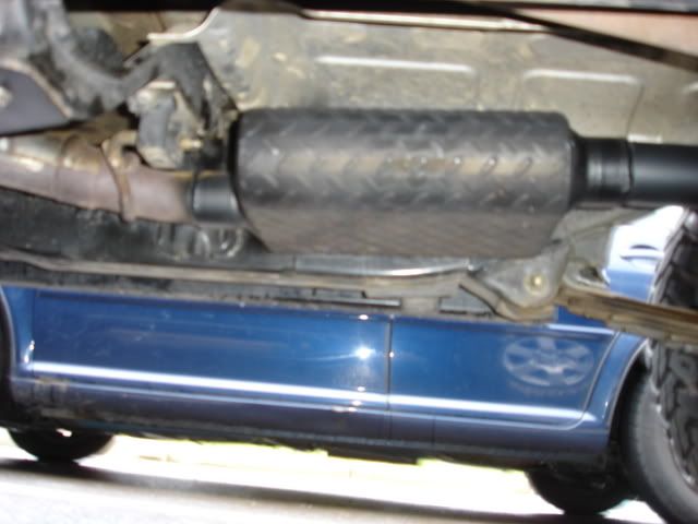

Last week I crushed the OEM muffler at the niora run so while looking
into a replacement I came across the new flowmaster super 44 off road
muffler and bought one from 21st century exhaust for 70 bucks.
I had it welded on yesterday to the stock pipes and it don't sound half bad but it was more the strenght and size I was concerned about anyway
it is tucked above the frame now closer to the body and has a 14 gague dimond plate case around it for protection if anybody is intrested the
order number is 942448or

My camera didn't do the sound of the muffler any justice so I will not post it.
again, this is more for durability then sound anyway but it has a deeper tone then the oem and is louder also, I kind of wish it was quiet for when I wheel where I don't want to be heard :tongue4:
