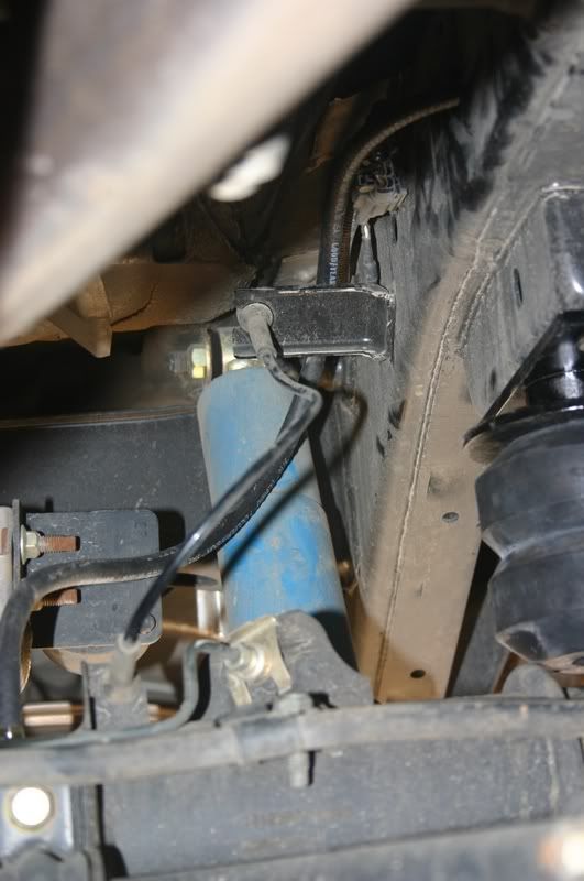

Those were the mounts - nice and clean - Thanks to Shrockworks. 30 minutes for both sides.
Finished product looks like this:
Then it was on to the bump stops. Timbren in the rear before the AC Shackles:
Then after the shackles... I don't think I'll shim them down unless I don't like the ride.
And the Energy Suspension poly bumps on the front:
Then the AC Shackle kit:
Then the AC Rear Diff Armor:
Then the breather mod (Bioman style :alien: ) with the fish tank filter...
but notice that I got the tubing to run INSIDE the frame all the way to the back - best protection there is I think...
And then I took the flaps off... I agree with the masses - It's a much cleaner look.
And now I would like to add a bit of my own... I was psyching myself up for the shackle job. After reading Dan G's post from 2004 when he got stymied by the shackles - I thought "Can I really do this by myself?" So I though it out, and I studied the manual, yes RTFM... I know, I know. BUT what I mean is that this site is the *bleepin* manual. If you can't find it here - or linked here, then it ain't been done. Just look at this... I took USMC-X's idea and got my come-along out, got the big pry bar, took someone else's idea (sorry I forget who you are) about jacking the axle using the pumpkin...got the X's jack out to lower the springs, set out my other tools, and went to work...
I mean, I was ready. So to my surprise - it took 30 minutes to do both. Holy cow. 30 minutes. Let me say it again :bom: 30 minutes! :bom:
Also, I came up with a way to lever the springs down to the new shackle mount point: Just apply downward pressure and viola - slide the bolt in...
That's just a 3' pry bar and an old C-Clamp... :cheers:
Let me say it for EVERYONE lurking in the shadows like I was.
PREPARATION = SUCCESS - There is no substitute.
All of this work took me about 10 hours. I'm NOT a mechanic, but I can do things other people cannot. I am mechanically inclined - others are not - and I think we all understand that and will support you either way. I found these mods easy and extremely gratifying both in the substance of the labor (of love!) and change in performance. I wish you the best of luck and I hope this post helps whether you choose to do the mods yourself, or have someone do them - either way you and your X will benefit.
Mike

Well that was cool to look at! I like your optional way to pull the spring down. Send me a PM with the link to that picture so I can show your way in the Timbren Bump stops thread so people who may not have a bottle jack have an additional way to do it. Cool!

MagicRat - That's the newer version of the rear diff armor from AC. I waited to order all of this stuff from AC until the rear armor was right. I've been monitoring a bunch of threads here for almost 6 months - just biding my time until it was the right time...
Scrabo - I didn't get my front stops from Autozone, but I think so. They are from Energy Suspension - I can get you the part# if needed. They took about 10 minutes to remove and isntall both sides. Really easy and I'm tickled to death how it cures the front-end roll/dive on hard turns. I haven't been off the pavement yet, but I might end up trimming a layer or two off of them to improve vertical travel.
