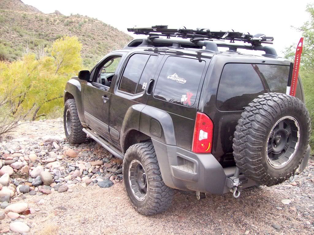

After saving my pennies for a number of years and the scratch that comes in on paychecks, I have put bundled it all together with a rubber band and thrown it into a mod pit! Typically I do one big project each summer. Unfortunatley, for my wallet, the project costs seem to have grown each year.
Farley19
Year: 2005
Color: Superblack :rockin:
Exterior Mods-
Removed the mud flaps, added Fog lights, hood rod mod, bug shield, stubby antenna, Shrockworks front bumper with Warn 9.5xp and 2 hella 500's, Shrockworks rear bumper with tire carrier and High lift jack, SW sliders, Rancho 9000 fully adjustable rear shocks, aftermarket shackles, Deaver AAL, total chaos uca's, Radflo Coilovers. Procomp wheels 7189 and (pictured) Mickey Thompson 285/70/17 Baja MTZ's. Current Tires are BFG KM2's 285/70/17. Custom install "through the tube of the rack" with alley lights and rear driving lights (4 Hella 75ffs). In front: Xoskel low pro light bar rack with 4 Hella 75ffs. (Seasonally) Thule load bars and rack up top for bike, ski/snowboard and a kayak. Nismo cold Air intake. Automatic Start/security system, Kleinn Train Horn, On Board Air, Shrockworks skids underneath and rear dif cover. 6 white LED rock lights on frame underneath. Gobi Ladder on the rear hatch and last but not least... Doug Thorley Headers and DT catback exhaust.
Interior Mods-
Ipod/XM/stereo/DVD HU, with blue tooth for hands free telephone use and rearview camera. Garmin GPS, replaced stock speakers with Alpine Speakers, custom stealthed amps, two custom subs, lobo w/lights and Maglite, sunglass compartment, and rear view mirror with temp/compass. Monitors in the headrests. All weather floor mats. Lots of switches for the exterior lights... Steel cargo divider. Fire extinguisher mounted on the divider. Recently, I installed a plain jane Uniden CB in front of the shifter and the quick detach firestick sits on top driver side. It's mounted under the roof rack module.
My Xterra Pics
Was
Now

The original lift package had daystar leveling kit spacers and quick lift shocks up front. Now the Radflo coilovers are in. The rear (1st shot) had nothing but shackles, but the rear in the 2nd pic has Deaver AAL and Shackles. The front is a bit lower after the suspension/bumper change but I can articulate much better and I have down travel. It rides (and corners) much much better. With leveling kit and quick lift shocks, the wheel was all the way down all the time, because of the height, the UCA was down against the shock bucket squashing the bumpstop, not giving me any down motion? In other words, it was rough over a speed bumps. Now, no problem.
