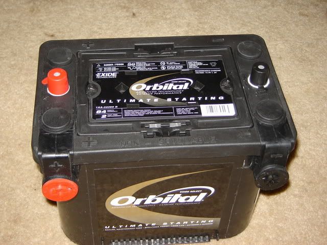

Okay guys just purchased the Exide Select Orbital for $135. Its not the top of the line but i figure it will suit my needs. the best one they sell is the Exide XCD (extreme cycle duty) but since the retailer didnt have it in stock i went with this one.
It has 1000 CCA @ 32'F and 770 CCA @ 0'F
The terminals are in the middle so there should be no problem with instillation (I havent tried yet because my navigation system is being installed).

Okay guys.... obviously i was wrong about it fitting! Because it wont without some modification to the positive connections.
So... if anyone can find the post that was around here about four months back where a guy moded his positive wire connections to fit a new battery that wasnt reverse terminal. It would help a great deal!

I was going through this issue about a month or two ago, when I was trying to find the proper yellow top to buy. Well I decided to check out Exide at my local Exide dealer and went with the Xtreme because I plan on getting a winch in the future. All I had to do was buy a 8 or 10 in. positive battery cable(I bought the shortest one that I could find but can't remember if it was 8 or 10) and hooked it right up. I have been using it for almost two months with absolutely no problems at all. I can't post any pics because no digital camera at the moment. Hope this helps.
