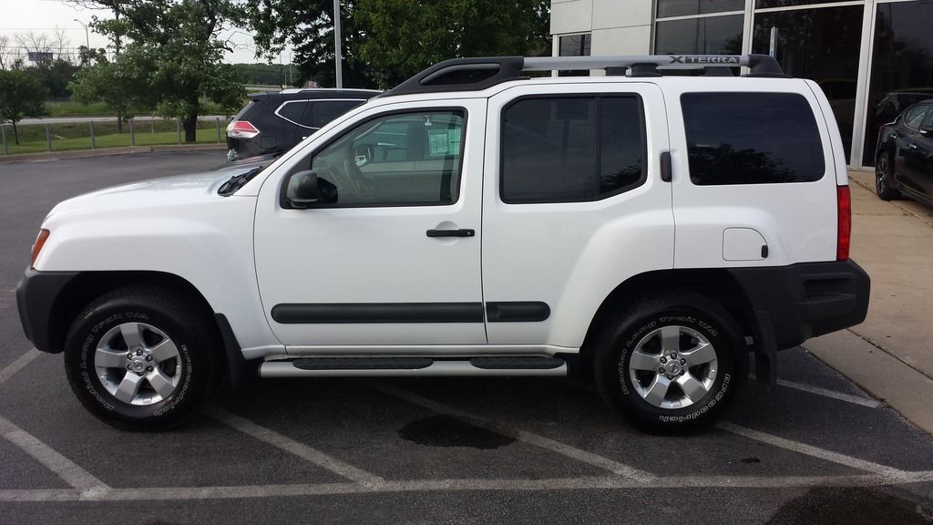

Intro Comments: Purchased 7/6/13, This is my first off-road vehicle and I am loving it! Lots of plans, taking it slow, as time and money allow! Currently saving for my suspension, plan on picking all that up in March.

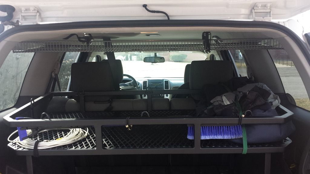

Awesome mods! I like the roof rack. Interesting mounting method, bolting it straight through the roof bars. Are those rubber grommets on either end of the bolts to seal off the hole? Also, it looks like you have 3 horizontal cross bars underneath the wire mesh. Does that provide enough support for gear, or does that mesh flex? Sorry for all the questions. I'm in the planning process of building my own roof rack. Sweet mods!

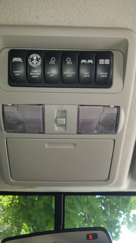

I like the overhead switches. Looks clean. Have you wired the switches yet? I have plans for something similar.
All of the wiring for all of those lights are completed, even though 3 of the switches go to nothing as of yet. I was able to keep everything very organized and compact by building my own mini harnesses, and doing it all at once. Each switch has its own fuse on my Bluesea aux fuse panel, and all are properly setup with a relays, which are located below the radio. Wiring from the relay to the light location is also already in place, so all I have to do is mount lights and place a fuse. Even properly labeled and tagged all my wires to a corresponding diagram, so I know what wire is what once I see a number. It was a really fun project, and one that really pays off nicely if you plan ahead.
Yes, I bolted the rack straight through the bars, using thick rubber for the rack to rest on, and compress down on to. This made dealing with the slight arc of the roof rack a LOT easier. Between the 3 bars and the mesh, I have not had any problems with too much flex. If you do a search for dephep roof rack, there are about a dozen different variants on design of these things. I used 1 inch 18gua square tubing, and it worked well, just gotta watch welding up stuff that thin!
here is another pic of when it was being built
