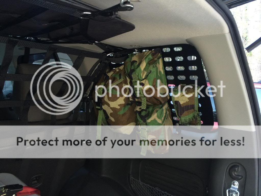

First impressions are that each panel is pretty beefy. I won’t be strapping particularly heavy items to them, but they would definitely handle some amount of weight. I generally don’t like having heavy items above the height of the rear seats for safety reasons though.

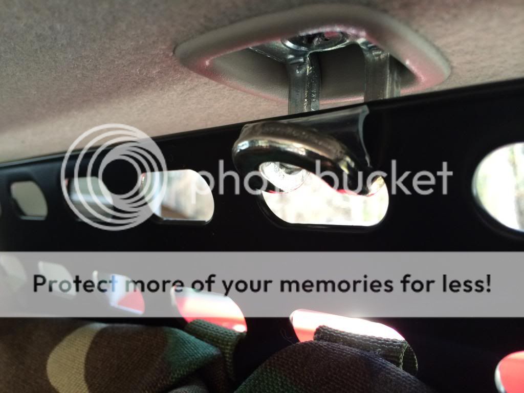

The panels are mounted by suspending them from the metal cargo hooks beside the rear side windows, and then attaching the bottom legs to the window plastic ledge. There were both bolts and screws included. I went with the screws.

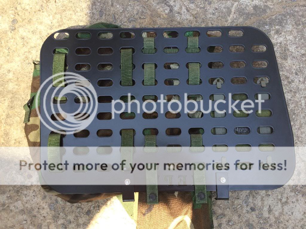

Assembly and installation were pretty simple. Align the bolt hole on the panel with the hole on the legs, and bolt them up. I placed the leg behind the panel with the feet in front for easy removal if needed. You could do it any way you wanted. Dephep had recommended to loosen and spin the hangar hook 180 degrees so that the opening faces inwards. That makes the panel easier to mount. I made one small addition before mounting, and that was to place a strip of cut clear rubber hose where the panel connects with the hanger. Probably overkill, but I just wanted to avoid any possibility of metal-on-metal rattling.
The cargo hook goes into the very middle slot on the upper row. There will be four slots either side of the hook when installed (counting upper row slots only). I had actually planned to black out the rear windows entirely and store a blanket behind each panel, but some test fitting revealed that it was not going to work out – at least not for the thick wool blankets that I carry. There was just not enough space behind the panel for that.

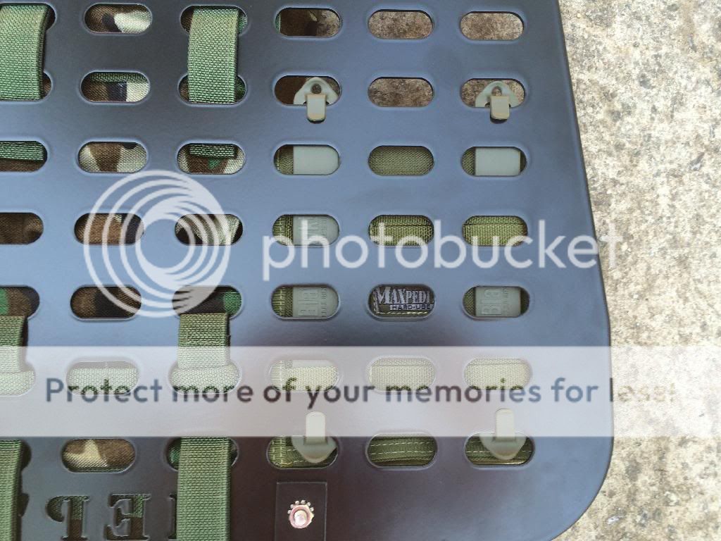

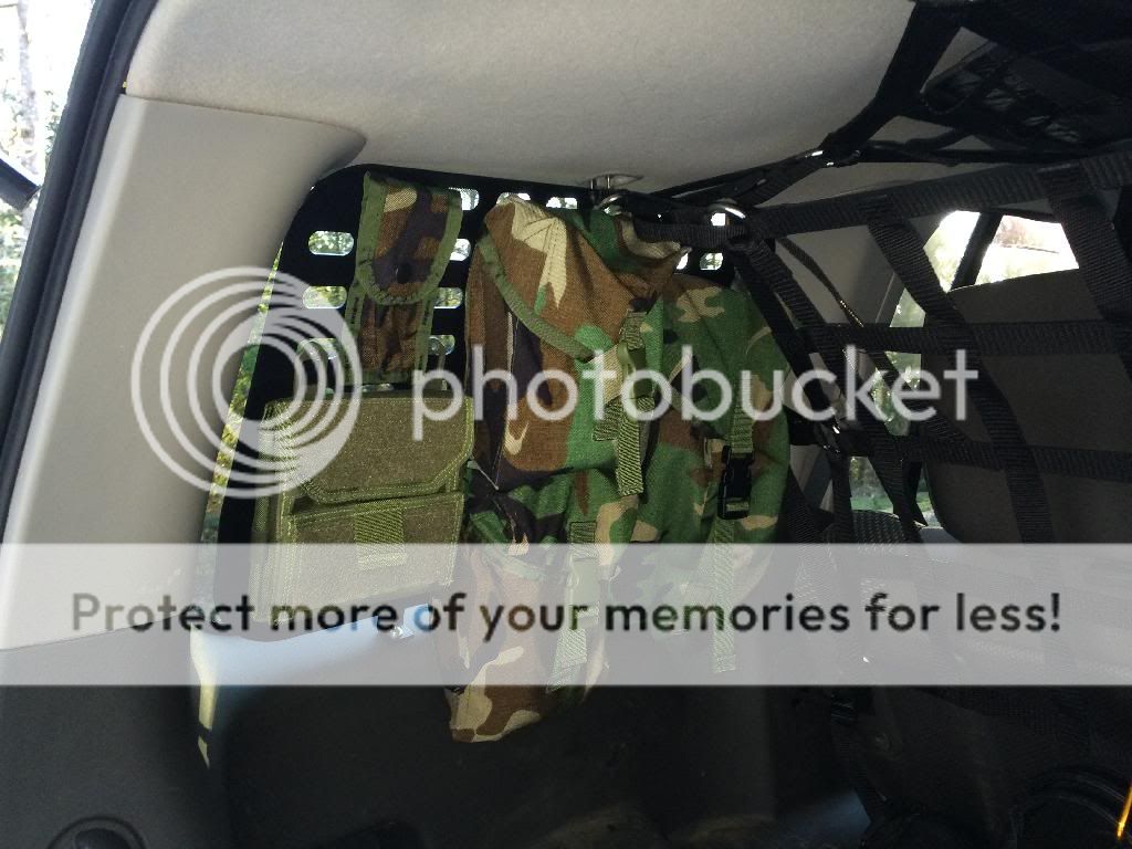

Because of the nature of a solid slotted panel, it is not possible to do a proper PALS weave when mating the MOLLE pouches to the panel. Only PALS to PALS webbing can achieve that. However, you can get pretty close on many pouches, and I don’t think any of my pouches are going anywhere. You do need to consider the size of items being placed in the pouch. Not all items are going to be able to fit into the pouch mouth due to proximity to the ceiling. Wherever that was a concern (like with sustainment pouches), I attached them on the second row down. Here’s a couple of pics of the rear of my driver’s side panel:
I did install the pouches before screwing the legs down – easier that way. Blackhawk Speed Clips can also be made to work, but not properly, and not for any real load bearing requirement. You can see a single admin pouch held by Speed Clips in the above pic. I used one sustainment pouch (the large one), two SAW 200 round pouches (middle), and then whatever I could find kicking around on the ends. I will probably end up removing the smaller pouches. If you have Raingler nets, you might have to use the panels as attachment points if the cargo hook lacks sufficient space. That’s what I did for ceiling net.

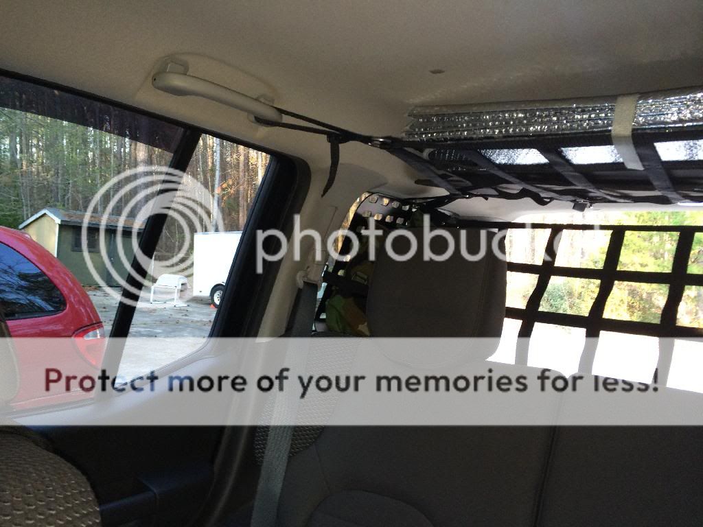

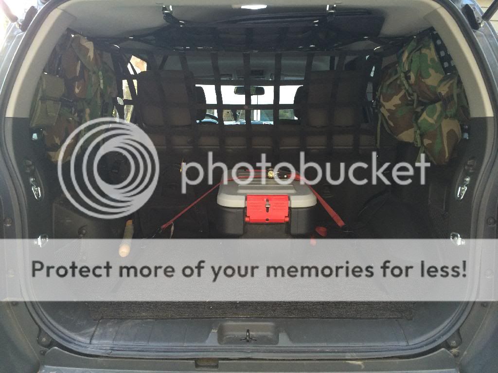

From the outside, it is pretty hard to clearly see the panels because of the window tint. That can vary depending on lighting conditions of course. View out of the passenger side rearmost window is restricted, but I’ve been driving with that installed for a week now and barely notice it. Obviously, there’s no concern on the driver’s side as you can’t see out of that window anyway. I really like these panels, and I’m happy I installed them. :) Here’s the rest of the pics showing the completed installation.

@ Bosco - zero rattling as there is no metal to metal contact. See the OP where I use a small piece of hose between the panel and the metal mounting hook.

That looks pretty good. My only critique is that it would be nice to somehow push it back further in towards the window to maximize that space. I just know when I've got the X fully loaded, every extra inch of space counts. But, I'm not sure how you'd be able to mount it because you'd be pushing the dephep panel further in than the cargo hook.
Regardless, that looks really, really good. Tempting...
595 Posts
Discussion Starter · #13 ·
You can push it back more. I wanted pouches that could also hang lower than the panel though, and pushing it back more makes that tougher. I also used the holes that I had made during the blanket test fit fiasco. So there's that... :)
