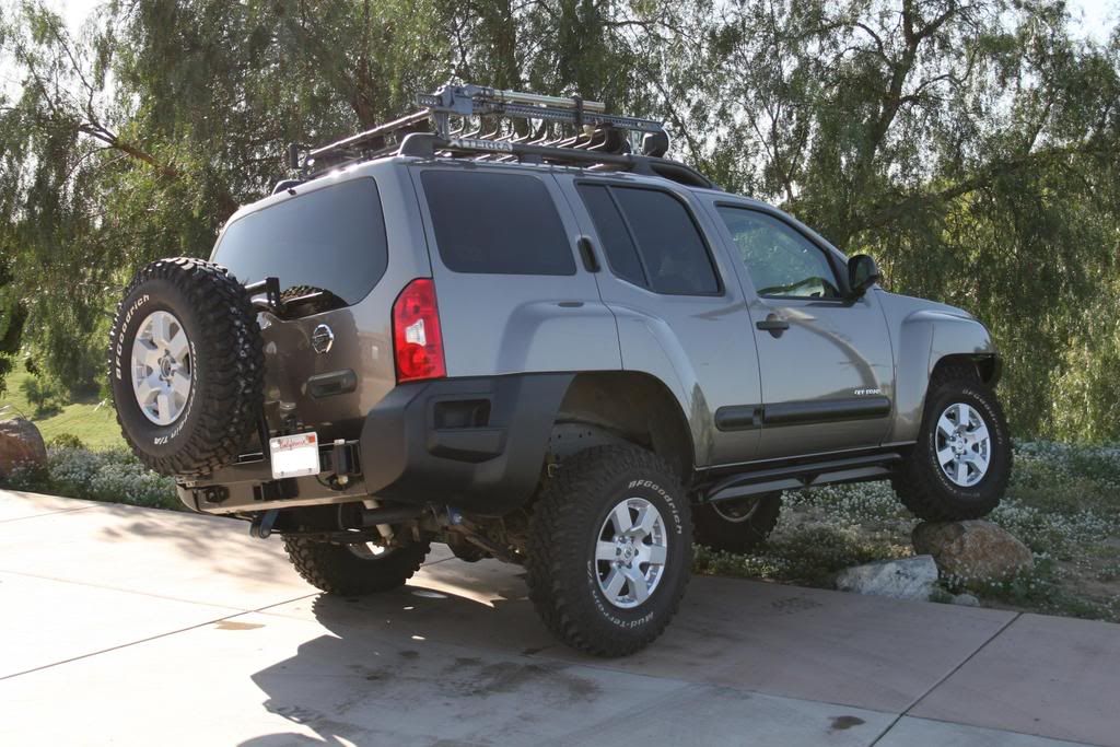

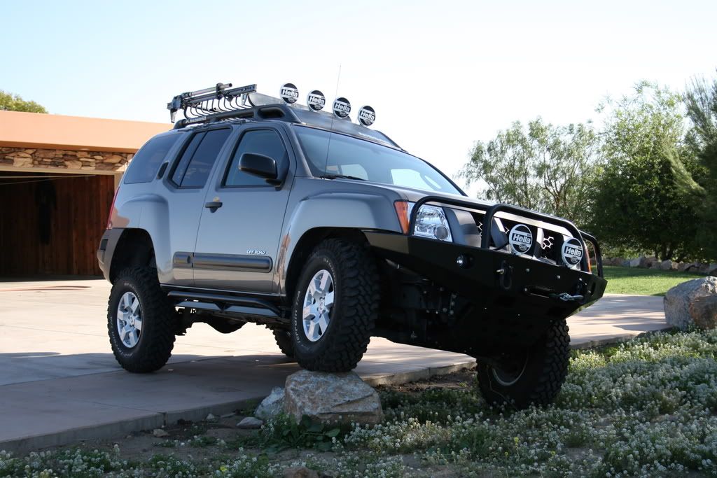

Haven't been posting much recently, but I have been lurking around. Cleaned the X for the first time in a while this weekend so took a few driveway shots (Maybe since it's on a little rock so it makes it ok?); hopefully I can get out on one of the SCCX runs to get it dirty soon:

Great X man. Do you remember what you used to paint the plastic bumpers black? They look great. Not to hijack the thread so fast but you and Syndicate were tight no? He hasn't posted in forever and there was a thread a few weeks back inquiring about his health and well being because of the fires.

Nice X!
Black bumpers look cool!

The bumpers...man I always stretch to remember. It wasn't anything fancy to be honest, just a glossy black plastic spray paint. I took off the rear quarter panels (step panels or whatever they are called) and painted them off the car, and just stuffed newspaper behind the door ding panels to prevent the body from getting painted. It's been like this for about a year now and haven't had a single issue or a need to touch them up (though it would be easy). I just love how they blend smoothly with the black Shrockworks bumpers.

Thanks for the updates man. Did you prep the bumpers at all? I'm definitely jocking this mod.
589 Posts
Nothing special, just a thorough cleaning and you can use plastic prep (though I think I just cleaned the hell out of it).

That wasn't very clear on my part, I didn't mean that 'plastic prep' was a brand but more how I have always heard about how to spray paint plastic. Usually start with a thorough cleaning, then some diluted alcohol or bleach solution (not really necessary) to finish the cleaning.
Then you can use something like Rust-Oleum's Specialty Plastic Prime", or Krylon offers a new line of plastic finish paint called Fusion that is designed to bond to plastic without sanding or priming. After those dry, you can use 'normal' spray paint on top and it sticks quite nicely.

Yeah it's got all the goodies on it:
-Full Shrock Skids/Front-Rear Bumper/Sliders/Diff cover
-Total Chaos UCAs
-PRG Coilovers
-Calmini AAL and Shackles in rear
-Rancho 9000x in rear
-255/85 MTs
-8500 pound winch
-Yakima Roof Basket
-K&N Intake
-Gibson Exhaust
Then the other little tweaks like removed sway bars, breather extension, air compressor underneath the seat, cobra cb, optima yellow top battery, and I am sure lots of other crap I can't remember...and of course it's the off-road model so I can lock the rear.

Are you running a front sway bar Erick? Your truck seems to have more flex in the front than most X's.
