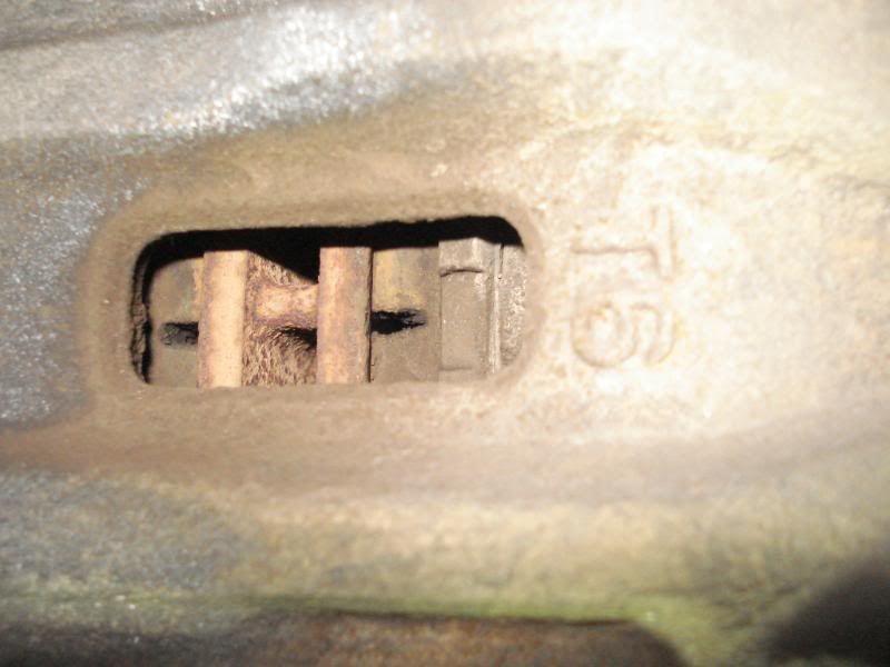

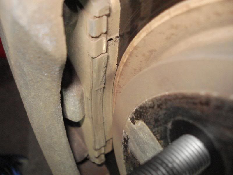

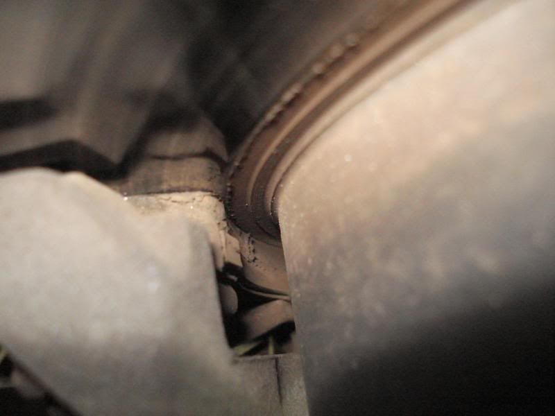

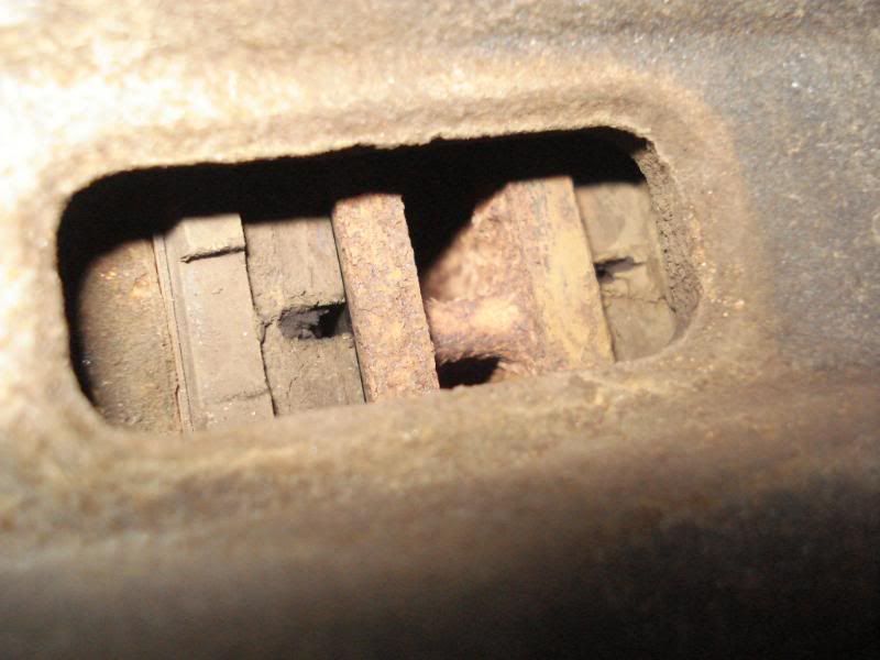

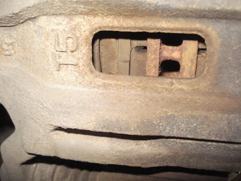

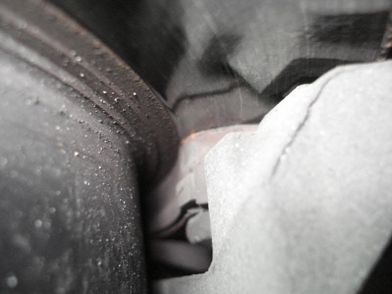

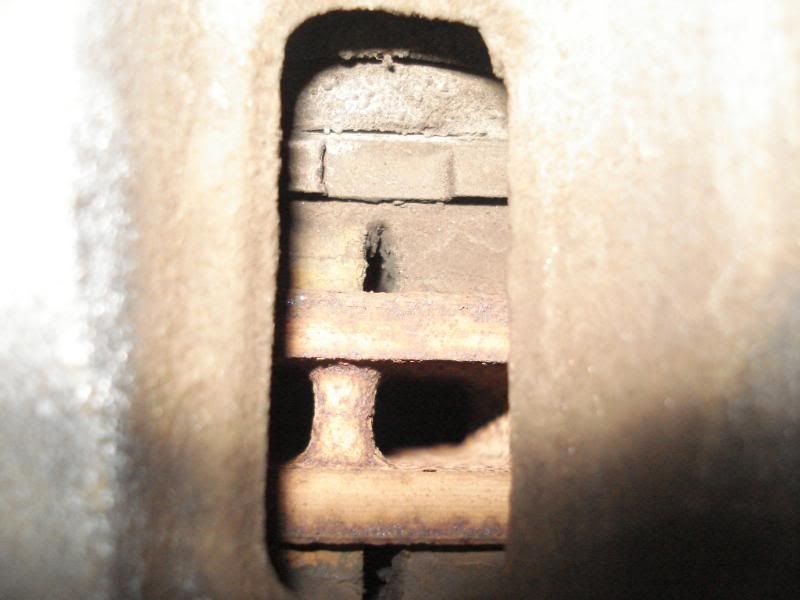

I have pulled all 4 tires off to check my brakes. I get that crazy squeeking noise when the truck is cold. First thing in the morning, especially when in reverse. It looks like I have lots of life left on the pads. Can anyone out there who is a brake expert give me an opinion.
Front passenger
Rear passenger
Rear Driver side
Any help would be great!!
Thanks,
Mike

looks good, maybe just some grooving has created the noise?

the rotors seem pretty smooth as well. Not much grooving at all
I thought they looked like lots of pad left.

pad life looks great.....use brake cleen and eliminate brake material, may help, then apply brake anti squeel gel.......probably not needed though....
the noise when reversing is nothing to worry about, cars are driven 99.9% of the time in fwd.....the pads, especially cheesy oem pads (most manufacturers) wear semi(microscopically) directional i.e. fwd.....Sooo, when u reverse especially in the morning when cold, the brakes squeel....

Once the disc begin to wear a little they can develop a lip on the outer edge which can hold in water and over night a bit of flash rusting which will cause squeal for the first bit until the you scrub off the rust. By the time you get to the first stop sign) I'd go more with te idea of directional wear thou, particularly if you only get it in reverse.

The brake pad on the back side of the rotor has what is commonly referred to as a squeaker. It is a piece of metal that is designed to rubb the rotor when the pad wears too thin. If the pad is not worn to this level than you are still good to go.
