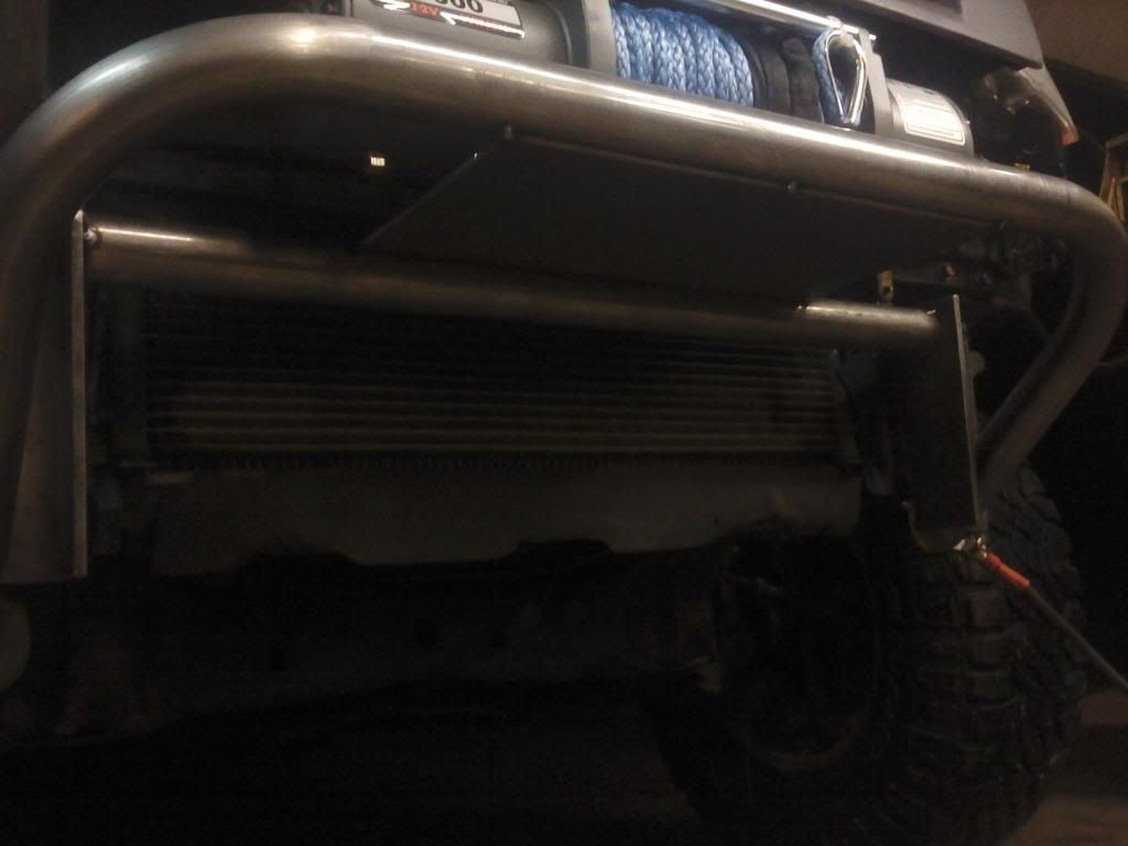

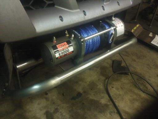

I'm having a custom front bumper built that will wrap around the front fenders and eventually tie into the sliders (also custom, welded to frame). Once finished, it won't be removable.
The basic design takes its inspiration from Maxterra's one-off tube front bumper:
This is a picture of something he did recently that is somewhat similar:
This is a bit of a teaser post. I won't have any decent progress photos until tomorrow. Here is the best I've got so far. They were taken yesterday, really just the winch cradle (for my new Engo ES-9000:headbang:)

He busted his tube bender so I won't get another update until Friday.
He said he trimmed about 3" and is using 1.5" tube, so the new fender height should be about 1.5" above stock. I don't think that's gonna leave enough for a standard snorkel. That's ok though, I don't need to be in water that deep anyway.
We're working on bracing it off the frame as well as tying into the bumper and the sliders. No sure exactly how that's going to work out, but it'll happen.
At one point I was considering getting the Dirt King shock hoop kit and bracing the fenders off the shock hoops. Those hoops have a bar across the engine bay so they'd be super sturdy. Fortunately/unfortunately I stopped myself before going down that rabbit hole. Shock hoops lead to new shocks which lead to Titan swapping.
