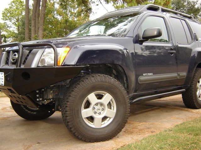

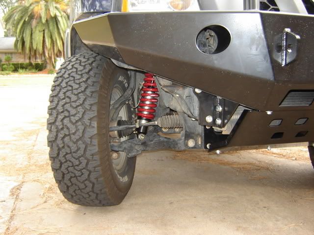

Okay fellas, i am extremely satisfied with these things. All i have to say is that there is a Night and Day difference between these and the AC coils with rancho 9000 shocks. There even seems to be a little more lift. I know that the AC coils claim to add 2.5" of lift (and maybe they do) but i have the radflos dialed in at 2.5" of lift and they are definitely lifting the truck a little more. I cant wait for my alcan springs to arrive.
Now all i need to do is go to firestone and get my free alignment! :cheers:
Install was a breeze! Just a matter of unscrewing four bolts (three on top one on bottom) per shock, then screwing four back in.

In the first picture you can see why you need the new UCA's. It looks awesome! When I get a chance I will update the suspension lift sticky.
