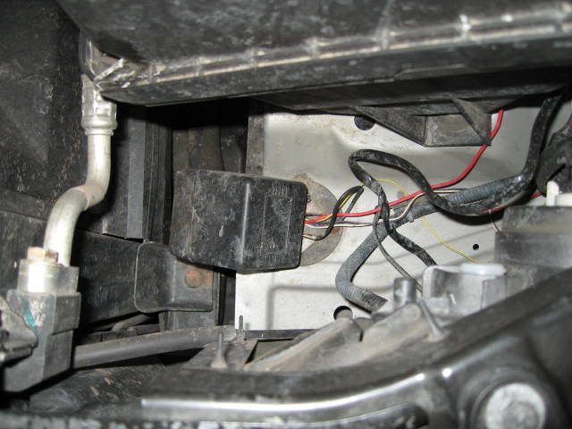

I should have done a how to. But before thenewx.org.
Buy the one with the LED light. Bulldog talking alarm.
It was a tight spot but Driver side below air cleaner and in front of it.
Run the power wire back to firewall and around to battery.
(You will need extra 10' 14 AWG Wire) Hook to Bat with fuse near it.
Now secure the alarm in that spot, horn faces engine and kinked towards ground and front slightly, really don't matter how ever you can get it in there. (You have to remove alarm from the mount after fitting and then screw down the mount and re install the horn to the mount. PITA)
Looking down at it installed from top driver side headlamp area under hood.
Now, run the wires for the LED through our famous hole in rubber below where the brake MC is about 12" down (I poke a wire grabber from inside and pull it in.) Now, Remove the driver side speaker cover and fish the line up into the speaker corner Right rear, Then drill or dremel a hole the right size to hold the LED. Put LED into speaker Cover and re install that. (Make sure wires don't mess with speaker. Now follow included instructions on how to set it up. They have some options. Adjust it.
You are going to be very impressed with it once you adjust it right.
Note, I kind used some double sided tape on the horn to secure it to the body so it would not jounce around too much when off roading. MC
