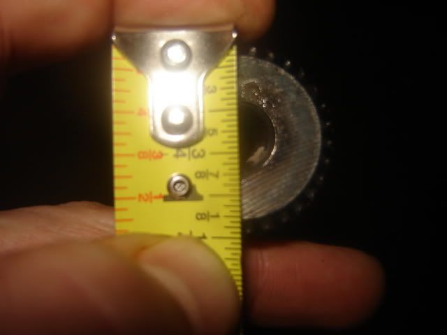

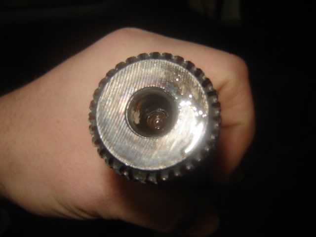

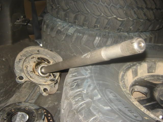

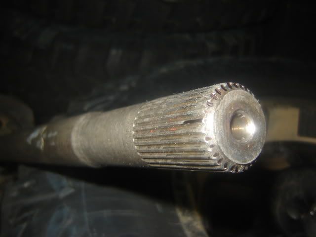

well guys when the tire flew off of my truck it turns out that i screwed up more than just the rotor... I messed the axle shaft up. BUT that let me get a chance to see if infact our C200 diffs had 31 splines. THEY DO!
Now whos going to be the first to put an ARB air locker on?
**UPDATE**
Shaft diameter is ~1 1/4" I need a caliper if i am going to be able to tell if its 1.31 or 1.26

Some of the old Xterras have a C200 rear end with 31 splines, which has an ARB locker out for it... the reason why nobody tried it on our trucks is because nobody knew if our trucks were (without a doubt) 31 spline or 32 spline.
Now we know....
