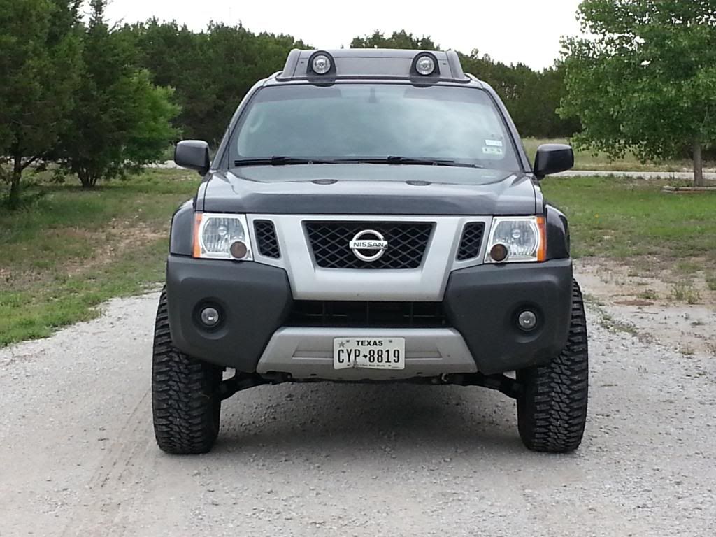

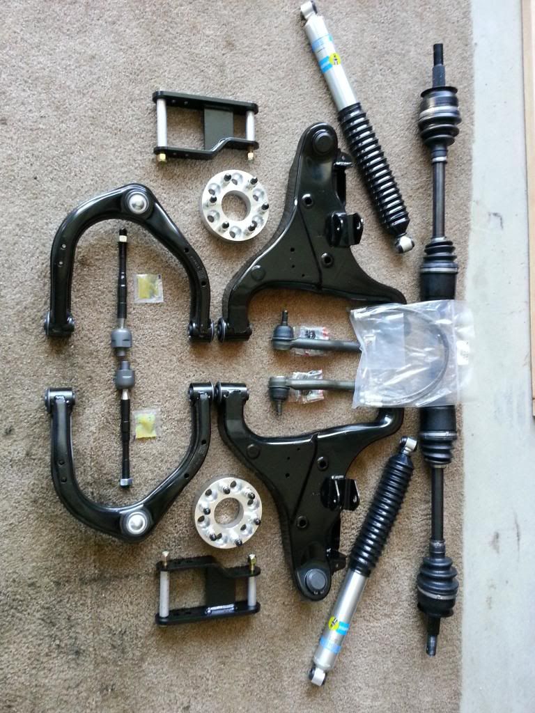

Updated with pics.
Everything that I have read says that the TS will not give you any lift, but I took very accurate measurements of everything before and after and the TS provided an extra 1" of lift.
I have the adjustable shackles set at the lowest setting. It is worth noting that I had to pull both of the rear ABS wires out of one of there mounting points to prevent them from ripping off. The rear brake lines are close to tight so i'm going to get some stock Titan rear brake lines ($12.99ea) just to be safe.
The difference in the ride is amazing; this thing rides like a caddy now.
Total cost of the swap including the rear shocks and shackles was under $1500
I do have some rubbing on the front bumper on the left side, but I think this has to do with the tree that I pushed over while climbing a hill last weekend. But it did not rub before the TS.

That's a great start. Glad it came out so well. Thanks for talking pics of the Xterra vs Titan parts, I'm sure people considering this lift in the future will consider those comparisons useful.
Also you're correct that the TS itself provides no lift. The lift comes from your selection of new springs, spacers, and shackles.

I think you misunderstood, yes the shackles did lift the rear. But before I did the shackles I completed the front.... No lift was added.... Just the TS... This added 1" of ride height. I check after the installation, after the alignment, and after driving it for 2 days.. It is still 1" higher than it was before the TS. Still 1" higher after I added the shackles to the rear.

I think it rides great. It is kinda soft, but even with the stock uppers it doesn't bottom out.
There are a series of dips in the road i drive every day that would put my head into the roof when the X was stock and would almost make the tires come off the ground with the lift, now it is almost unnoticeable with the TS.
My next purchase will me the PRG uppers though, just to get the caster right. The steering is a little sensitive.
