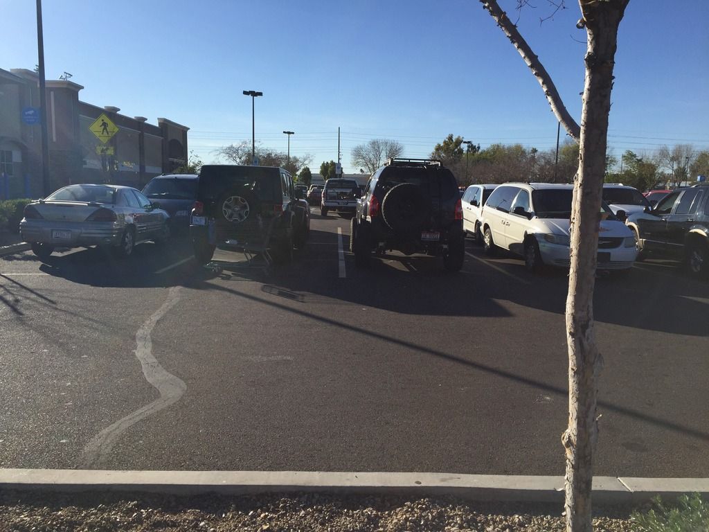

Couldnt help but to get a pic parked next to a rubicon. Had a good 6 inches on it. Should have seen the owners look when I pulled up and they looked up to me.

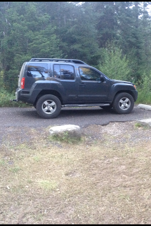

One of the few pics I have of Bruce from early one, he still have a 1.5 in spacer up front and the OME leaf springs with adjsutable shackles in this pic.
