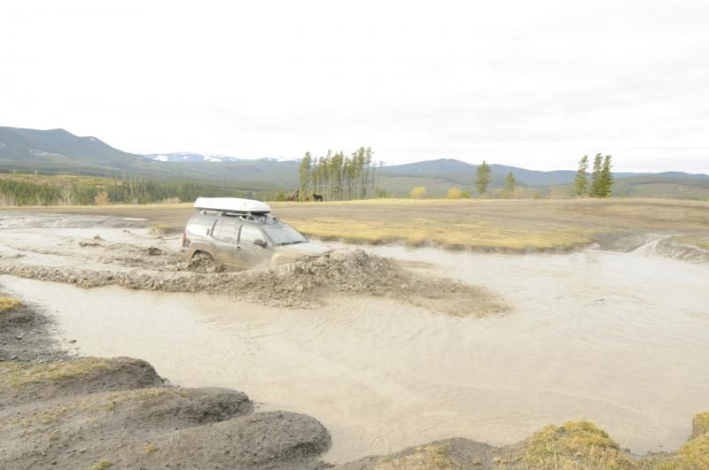

PS: I went through some FAT muddy water puddles and ingested water right down my air intake cowling on my hood, so this is why I think the motor on the blower finally died.
550 Posts
Yeah that was that day with steady.... i'm not normally a puddle person, but that day was the exception
