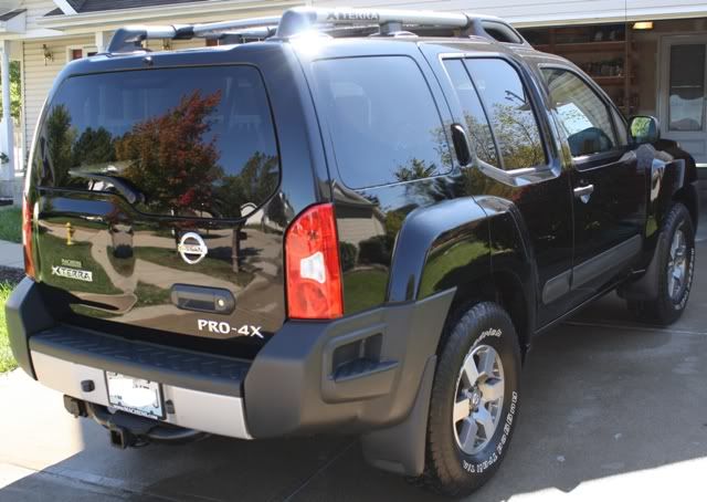

Username: BleednBlue
Year: 2011
Trim: Pro-4X
Powertrain/Driveline/Exhaust:
Airflow: Drop In K/N
Exhaust: Delete Y-Pipe. Added Magnaflow muffler (part 12580).
Sliders: Shrockworks
Skids: Stocked
Nissan Xterra Hood Protector
Nissan Xterra Side-window Deflectors
Nissan Xterra All-season Floor Mats

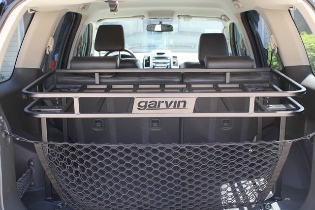

Garvin Utility Rack
Electrical:

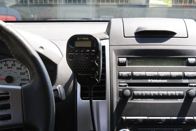

CB: Cobra 75 WX ST
Antenna: Firestik 3'
Antenna Mount: Comet RS-660U
GPS Docking Station W/CraigsList find GPS unit
PRG Radflo 2.0 Coilovers w/ 600 lbs springs
Adjustable Camber Bolts
PRG 2.0" Dual AAL
Bilstein Rear 5125
PRG Shims
Rear Sway Bar Delete

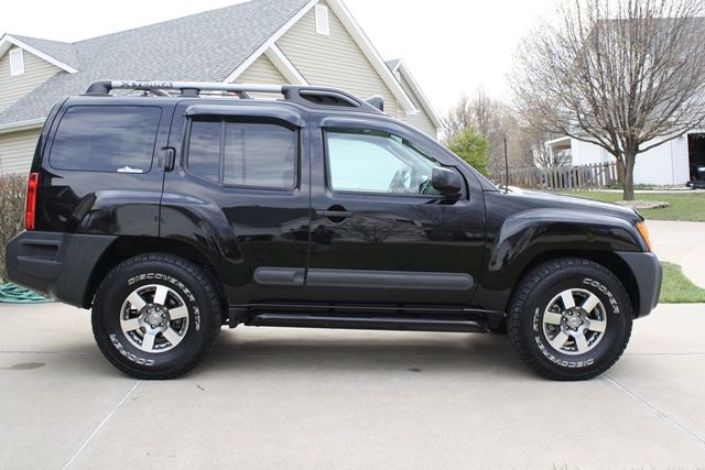

Tires:
Cooper Discover ATP 285/75/16
Recovery:
HiLift Jack & Accessories

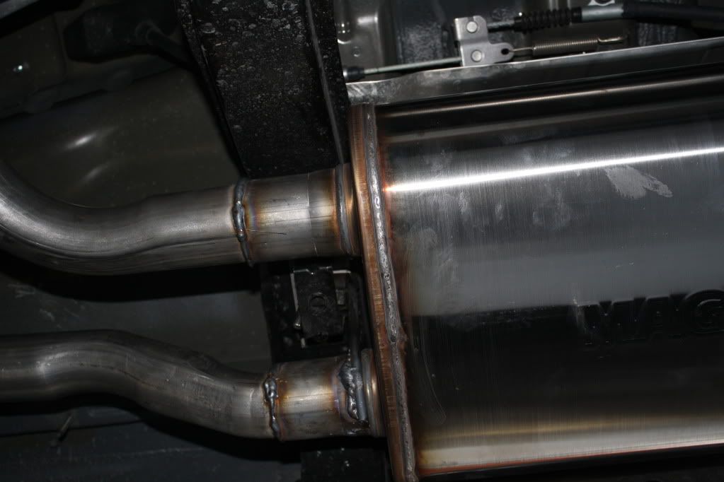

Magnaflow muffler:
My overall impression is positive. If you are looking for more aggressive sound without being obnoxiously loud then this muffler is a good choice. Deleting the stocked Y-Pipe is ALWAYS a good choice.

nice! when did you get the lobo rack?
also, can I borrow your SWR meter? or do you want to help my tune my cb? i have no idea what i'm doing...
9,791 Posts
Lobo has been deleted. Added the Garvin Utility Rack. Gearing up for Yellowstone & Black Hills trip.
How did the swr meter work for you?
NICE!
I'm a slacker and haven't done it yet. We ran into unforseen problems on the brake weekend. I'll get it done this week and get it back to you. :blackeye:

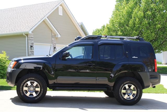

Suspension from PRG:
Rear Height 24 inches (bottom of center cap to bottom of fender)
Front Height 23 inches (bottom of center cap to bottom of fender)
Had to adjust radflos .25 inches up (width of spanner wrench) to get .5 inches of increased height. Goal is to maintain factory rake of 1 inch.
