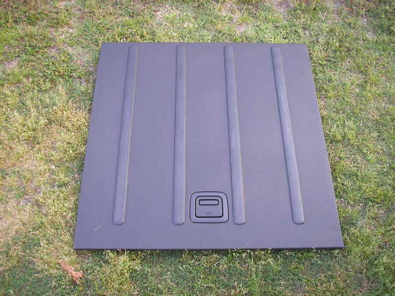

I think I put a post regarding this topic before, but I am starting a new one with pictures and goodness. :) I went ahead and started the bedlining process of the cargo area. The cover panel was by far the most PITA step, so far. It is of a different material than the rest of the cargo area, and the prepping really didn't do much for it. It might have helped if I cleaned it off afterwards, too. Oh well. It is coming along quite nicely, and I will keep the pictures coming as the pieces are done.
The cargo area cubby cover (I don't know the PROPER name for it :) ). This is before I sprayed it. Notice the not-so-great prep job.
My *awesome* spray job. Not so much. The texture of the cover really prevented it from giving the duplicolor much to "stick" to, so it was almost like I just sprayed it black.

Note to anyone who is thinking about trying this...make certain to do a good prep job. I didn't do a very good one on the cargo cover and while transporting the Shrock rear bumper yesterday, it did some peeling of the cargo cover. All because I did a piss-poor job of prepping. I am redoing it now and in the process, I decided to take the rubber cover off the cargo cover thing. It is just held down with a sticky substance, as well as a few screws and staples. It gives the bedliner something better to stick to if you remove it. Just be sure to sand it down good and clean it. Then go to it. Learn from my mistake. :)
