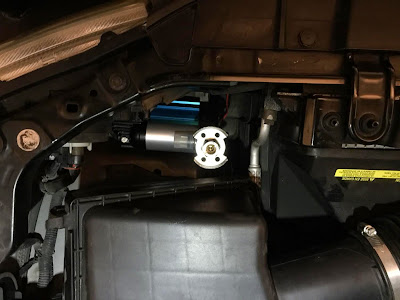

Well, I took the time to install the CKMA12 today. It was 100% super easy.
This spot in the engine bay was workable. It's easy to eventually install a bumper mounted remote line.
Wiring went along inside the front grille area where the factory bumper used to mount. It was exactly the right length.
The ARB switch fits in the nissan sized switch slots. I removed the spacer on the underpanel and stuff it in there.
Illumination was tapped off the 4WD selector switch. Its the red (with silver dots) wire on the 2005 Manual model.

I'm not sure I can see where the hose bib would connect.
10,980 Posts
XK - Here's the tech-specs: http://store.arbusa.com/Assets/PDF/compressorTechnicalSpecifications.pdf ... the CKMA12 is the middle-spec'd unit ... does 3 cfm, no-load, and ~2.3 @ 29psi ... so similar (or maybe slightly better) performance to the popular red MV compressors. Viable for tires, but maybe not as fast as some of the bigger units in the same price point (couple hundred MSRP) ... if you saw a really cheap one (<$100 MSRP) that was probably the CKSA12 ... which *is* just for lockers and not especially viable for tires, due to low output.
The CKMA12 can be set-up to use a hose by putting a quick release into one of the manifold ports (though they - I believe - are threaded for BPT, not NPT) ... that's where S&S has a solenoid and pressure switch attached in his pics ... they're the small items on top, in the side view ... the solenoid has a black wire loom coming out of it.
Ah, I got it.
Thanks!
