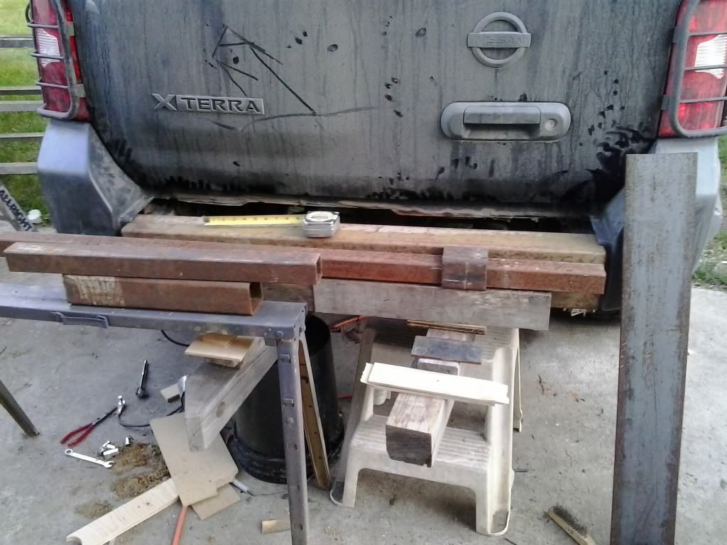

Well you're gonna guess and be right, but I'll explain it a bit further. it's a tire rack rear bumper, with the swing away carrier, hitch and recovery points. But going a little further, since I have onboard air and never had a tank, the bumper itself is made from rectangular stock with the ends capped off. presto. Tire carrier air tank hitch bumper! Rear-end me now, sucka. (could be akin to the exploding armor some A1-A's have.... I dunno....
And I'm ditching the trench digger trailer hitch finally (thank god)

Also if I manage to damage it wheeling i've probably bent my frame up over and through the back cargo area. that steel is 3/8.

I'll post up some pics when it's done. cutting and welding today..... God I hate cutting steel...

It's the internet demons!! update. air tank and hitch welded up. mood lit for effect.
