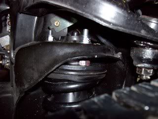

I put them on yesterday>>>
I am happy to be here,if you knew the journey i took to be here!Newbie with an 06 s x..lovin"it so far..3000 k already. Any way,easy install(Once the balljoint is off) and really dosent level it but makes the front taller! Will install shackles to level back and 33" this week... BFGS285/75/16 ONE THING!!!The nuts supplied to attach Spacer to top of strut do not Fit..the nut is the right size..however the Flange on the nut hits and cant be tightened.If that makes sense..Auto parts had nuts that fit just fine..(NOT the very top nuts on top of tower;supplied with spacer,factory nuts in between dont fit).

Did you notify the company of this issue? Might make it better for others down the road.
ON my list.....
