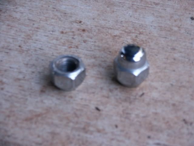

I couldn't locate any lug nut short enough to sit flush with the face of the adapter, so I used a cutting wheel on the grinder and cut the acorn tops off of each of the stock lug nuts. Sandwiched each lug nut into the vice before cutting it, 24 times. Took a while.

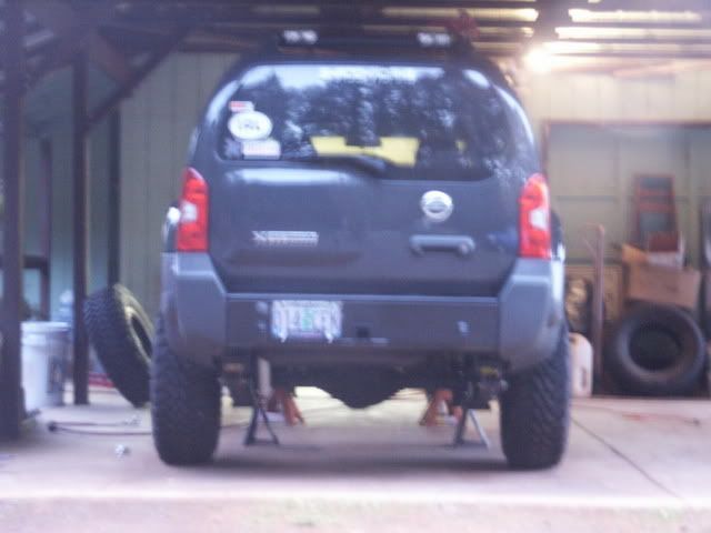

Used threadlocker on the lug nuts holding the adapters to the face of the wheel and torqued them to 120 ft/lbs. Back wheels went on without any problems. The wheel studs did not extend out past the adapter. I checked all of them with the straight edge of a framing square before bolting the wheels up.

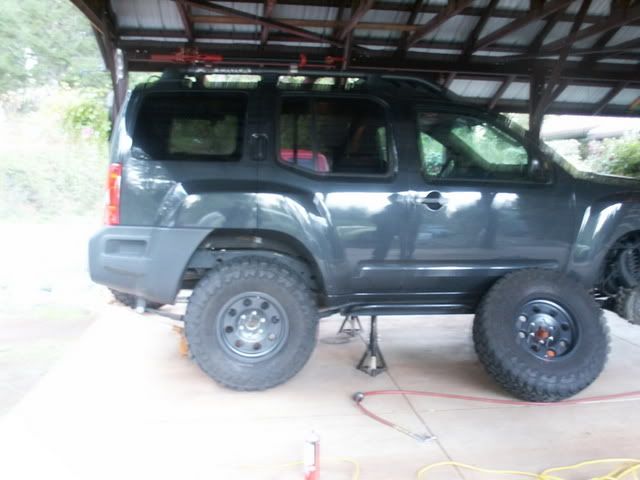

I think the wheels were pushed out about 1.5 inches. This should solve my rear frame rub problem. By the looks of things, the tires should still tuck up into the rear wheel wells without any problems. Here's another crappy pick to give you an idea what the new stance is like...

After closer inspection, I realized that my front tires (285/75/16) had been rubbing against the frame rail as well (closer to the firewall, under full lock I presume).
Anyways... as expected, the tires were now rubbing against the rear of the fender.
