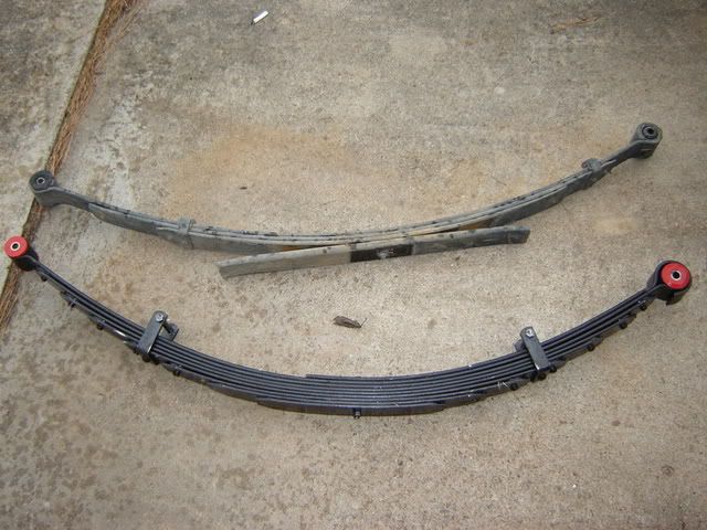

The leaf springs: side by side comparison

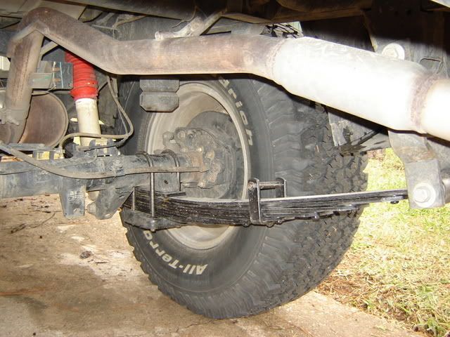

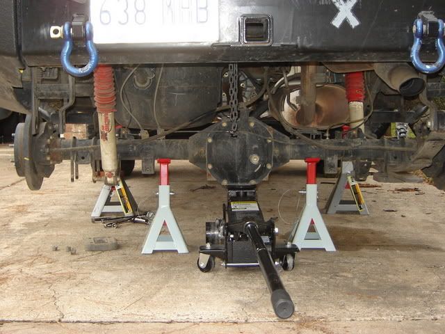

The install
This was the hardest part!! I fought with this thing for thirty minutes before i realized i could use a jack to push the spring into the shackle. Even with the jacks help it was still a struggle. Other than that it was pretty damn easy. I am an amature... No no, I am a novice... and i did this install all by myself!! (VERY EASY)

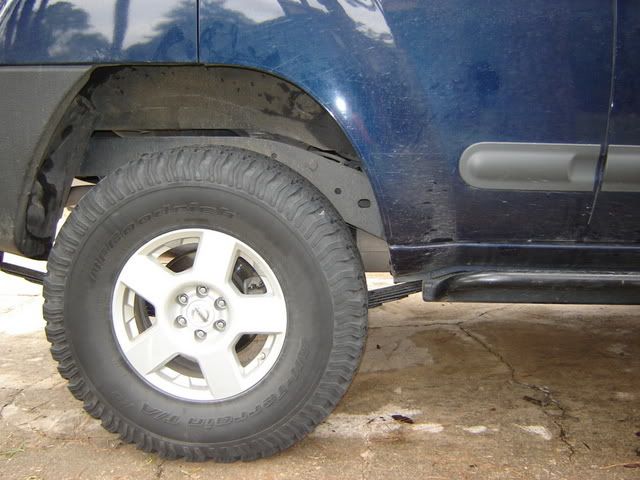

Kindof makes 285/75/16's look small. (now i need to find a diff drop kit so I can raise the front more :cheers: )

What is the front lift you are running with that?
Have you measured from hubcap to top of the wheel well on front and back to see the difference?
Do the brake lines look stretched at all (Are the aftermarket ones)?
Looks great man!
In front i am running the TC UCA's and Radflo coilovers. In the rear i have the AC shackle in addition to the alcan leaf pack. I also have extended brake lines, and relocated ABS lines. And also longer rancho 9000 shocks. So nothing is stretched out in the rear.
I am thinking about cranking the radflos so they give me a little more lift in the front, but i am scared that i will start having issues with the front CV joints.
:cheers: who cares i think it looks good!

Dang...practically the same setup I am running :geek: Just got Calmini in the rear (AAL and Shackles). It does look great though. On the Radflos, do you happen to know what height you have those sitting at? More specifically, how much room you have between the coil bucket and the bump stop on the UCA?
Ok, seeing as this is the exact setup I am about to buy (did my taxes, know how much I am getting back). What specs are the Alcan's? I know I had read that some wished they had gotten more lift when they ordered them.
Between 1" and 1.5" of lift (thats what i told the guy i wanted). I also have 100 extra lbs. of load carrying capability, with another 50 lbs for the rear bumper.
I am extremely happy with how they feel, there were a few hickups while installing them, but nothing serious. i have never worked on leaf springs before so it took a little extra time to figure out how to do it.

After discussing this with the shop prior to ordering my pack, perhaps it is wise to add 1" to what you'll think you need. The pack may settle some and perhaps sag a wee bit with use and time.

You're missing the whole vehicle side shot! Looks great!
Yea we want to see just how much like a drag racer that looks like! WOW! You can fit a set of chains on your rear tires now! Whhooo!
That's sick! How does it ride all that, keep reporting.
I can't do this, I like to leave for work no ice scraping, I know I won't clear the garage door with these on. But it does look good. MC
Here ya go! Personally im not a huge fan of the rake, but hopefully That can be fixed. Maybe I will buy calmini's 5" lift and sell the parts that i dont need. Hmmmmmm........ :scratch: :scratch: Should I do it??? :drunken:
1,407 Posts
Dang that looks tall! It looks great, it does make the 285's look small.
