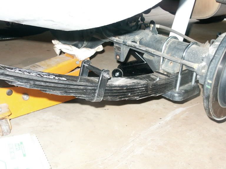

The Alcan spring pack was thicker than the stock leaf pack by 9/16 of an inch. You may be able to see it in this picture. The Alcan pack uses 9 leaves.

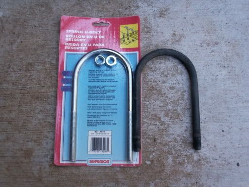

I fumbled around at my local auto parts store and managed to find a slighly longer U-bolt that fit perfectly. Here is the stock U-bolt side-by-side with one of the new U-bolts.
This U-bolt is made by "Superior Industries," and their part # is 13-0116. The measurements are 7/16 x 3-1/16 x 6-3/4 x 3.

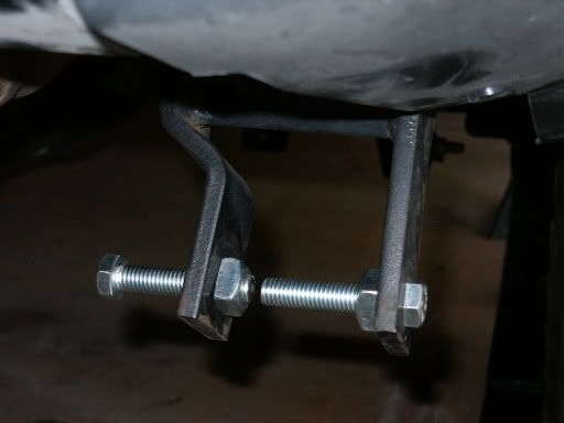

The biggest problem I had was getting the polyurethane bushings into my shackles (AC) and the mounting bracket on the other end. My dad (I never have the good ideas) came up with an easy way to spread the shackles and brackets apart. This one is a no-brainer. Slap a socket on the exposed bolt and an open ended box wrench on the nut on the exposed bolt and crank away. Worked great and made the install a sinch.
