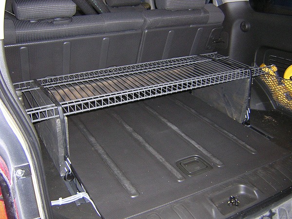

I wanted a shelf that could handle a lot of weight (photography gear), have enough clearance to put larger object on top, and still allow access to the floor-bin underneath. Below is my solution.
You can't see it from the picture, but the metal shelf is bolted onto the wood pieces and there is a cross-piece in the back for stability.
It has bolts under the wood that slip into the Utili-Trak rails and the bungee-cords hold it rock-solid. Best of all, you can strap things on the shelf that would otherwise slide around and you can still get into the under-floor bin without any trouble. The whole thing removes easily in a matter of seconds too.

Very Good! Congrats! It give me some ideas...
Can you post some details (pics) of the "bolts under the wood that slip into the Utili-Trak rails" ? Do you slide them in from the rear opening in the track ?
