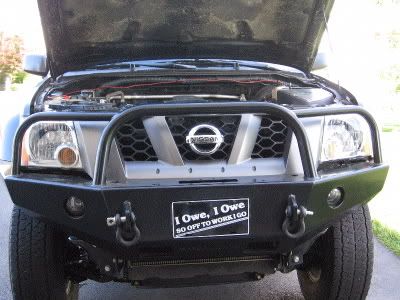

Anyway, I know you'll love pics so here's a few to show height, though, I also have the 2.5 AC coils in the front and the AALs and shackles in the rear. Next will be to figure out wheels and BIGGER tires. :happy7:
Here's a "good" one showing the gap that happens. :tard:
I need to call Jim at Shrockworks about a fix for it and to extend the skid longer to fit.

It's been a disaster doing it. I've only had myself, so it's been sloooow going. Constantly something stuck, something doesn't line up, need 3 hands, don't have the right tools, etc, etc.
As for the gap size, it is more like 4-4.5". The reason is the 3" from the lift + 1-1.5" just caused by putting on the Shrock bumper.
As for the headlights...looks like crap, huh. Functionally though, I have not tried the lights as the battery is still out of the X. If it casues problems, I know I can raise the bumper up ~2-2.5" by just moving the bumper up from 3 to 2 bolts. The problem with that is how strong it will be; fine for driving around but not much else.

OK, A quick update...
I got it back to driveable. The steering was a PITA.
I ended up raising the bumper as I mentioned. Looks as good as new...
I'll contact Jim on MOnday about a permenant fix and the skidplate.
