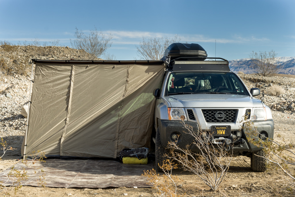

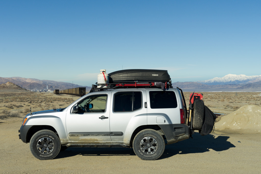

Intro Comments: My goal: A capable overland vehicle and photography platform.
Username: nworker
Ham: Yes Call Sign: N6HWW
Xterra's Nickname: PiXterra
Year: 2015
Trans: Auto
Trim: PRO-4X
Color: Brilliant Silver
Power:
- BullyDog Tuner w/ChargerCity Multi Angle Mount
- Volant Cool Air Intake Kit
- XTP Intake Manifold Spacer (Awaiting Install)
Electrical
- Dual Odyssey PC1200MJT batteries
- DC Power Engineering 270A Alternator
- Upgraded ground and alternator wiring
- Valentine One Radar Detector
- Uniden PRO520XL 40-Channel CB Radio w/RoadPro RP-550 36" Ring Tunable CB Antenna
- Yaesu FT-7900R Dual-Band 144/440 MHz Ham
- Dual battery setup using Blue Sea ML-RBS Remote Battery Isolater/Combiner
- Isolating solenoid for winch
- Solar charge system
- Victron 75/10 MPPT bluetooth enabled charge controller
- 100W Flexible Solar Panel
- Cutoff relay for all house circuits
- Two house circuits
- Front Cabin
- 11 solenoids behind center console
- 6 switches in headliner instrument cluster
- Front LED bar
- Rear LED bar
- Dust Light
- Rock Lights
- Rear Compartment
- 4 solenoids behind passenger cubby
- Smittybilt 2780 2.54 CFM Air Compressor in Wheel Well
- Inverter
- Rear cabin light
- Dometic CFX-65DZ Portable Electric Cooler Refrigerator/Freezer
- Melt mod
- BFGoodrich All-Terrain T/A 285/75R16 KO2
- Radflo 700 lb Coilovers
- OME Leaf Springs
- Removed Rear Sway Bar
- PRG U-Bolt Flip
- Timbren Bump Stops
- PRG Diff Bushing Kit
- Delrin Rack Bushing Kit
- PRG Variable Height Shackles
- 2 Degree Shims
- PRG Upper Control Arms
- Hellwig 500 EZ Level Helper Spring Kit
- Removed Mud Flaps
- Wade 72-69485 In-Channel Wind Deflectors
- Hi/Lo Beam 5000K Color Temp HIDs
- JDM 1200 Lumen Fog Light bulbs
- P&P 5 Piece 1/8” Skid Plate Set
- Rocky Mtn Xcessories Winch Mount
- MaxDesign Sliders
- MaxDesign Rear Bumper and Swing Gate with Rotopax mount
- LED Reverse and License Plate Bulbs
- Rotopax 1-4 Gal Gas, 1-2 Gal Gas, and 1-2 Gal Water
- Gobi Stealth Rack
- Gobi Passenger Side Ladder
- Gobi Hi-Lift Attachment
- Gobi ARB Awning Attachment
- ARB 2000x2500 Awning
- ARB Awning Room with Floor
- Thule Roof Box
- Raingler Roof Net
- Extreme Off Road Lighting 40” LED Light Bar
- 14.5" Kohree 90W CREE Led Light Bar
- LED dust light
- Trasharoo Spare Tire Trash Bag
- 2 PRO-4X Rims with Full Size Spares
- Smart Touring System Quick Fit Brackets
Drivetrain:
- Rear Diff Breather Extension
- No-Spill Oil drain system
- PRG Aluminum Front Diff Mount Inserts
- PRG Delrin Suspension Rack Bushings
- ARB m226 Aluminum Diff Cover
- ARB Front Air Locker
- Rugged Ridge Rear Grab Handles
- Kenu Airframe Smartphone Mount
- LED Dome Lights
- Heps Designs MOLLE Window Panel
- Heps Designs MOLLE Tailgate Panel
- McMaster-Carr 175 lb Rear Struts
- Raingler Interior Net
- Rubbermaid ActionPacker Storage Box, 8-Gallon
- Coleman 9-Quart Excursion Cooler
- Rexing V1 2.7” LCD 170 degree Dashboard Camera
- Rugged Ridge All-Terrain 82905.10 Black Front Row Floor Liner
- Coverking Ballistic Tactical Seat Covers
Recovery:
- WARN M8000-s Winch
- WARN Medium Duty Winching Accessory Kit
- Hi-Lift 48” Jack
- Hi-Lift Handle-Keeper
- Hi-Lift Off-Road Base
- Hi-Lift Lift Mate
- LITE-WAY Recovery Traction Mats
- Fiskars X15 Chopping Ax
