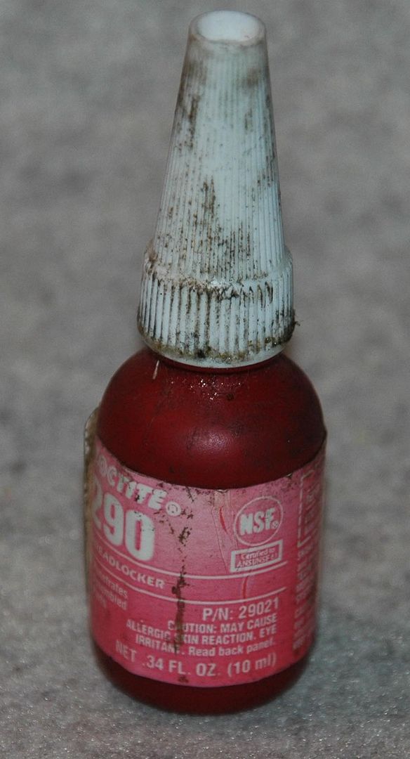

Step 5: Optionally use a bit of lock-lite to put a drop of sealant into the treads of the locking ring.

That's a dirty bottle of Lock-tite! I've been using that thing for years to lock the rings of my rifle scopes. I think it's time to invest in another bottle.
