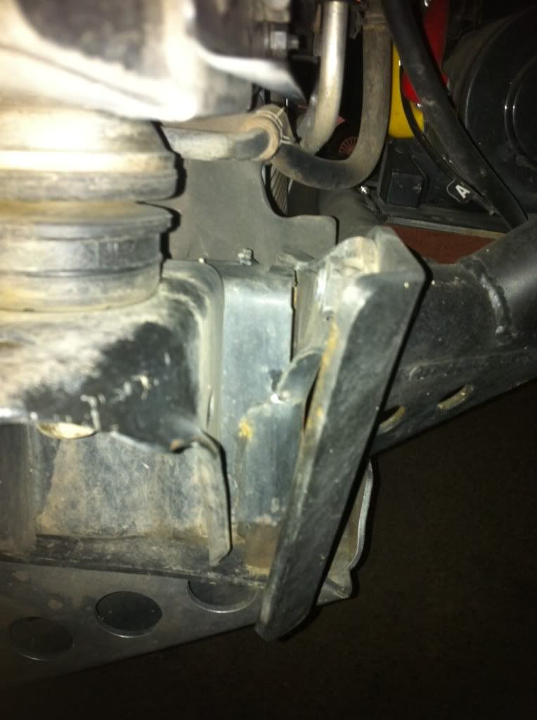

Pics below are the L bracket on 'before photos' showing how the holes to the frame just don't line up, and some of the gap where the L portion that bolts to the actual bumper was just too tall.

Initially, I thought I was going to have to cut the corners to make it slide up in to the frame bumper support flanges, which I did, however, once I got it bolted up on one side, I saw that was not necessary (Sorry for the blurry of the first photo with the cut corners). In the end, I had to cut a portion of the top off of the L part that bolts to the actual bumper (seen below), and then to make the holes in the back line up, I just cut all the way in between them to give me the most flexibility to slide it forwards and backwards. This was absolutely not necessary, as only the back hole had to be moved up (about another hole width forward of what they give you) and the front hole had to be moved back about half a hole. You can also see where I had to cut the L portion that bolts to the actual bumper shorter below.
The biggest hassle was figuring out exactly where it needed to be cut. After measuring, marking with a black sharpy (all I had, was a huge hassle trying to see on black paint at night) dremmeling, grinding, sanding, I finally just stopped caring about it being pretty and got the saw saz out and went to work. Once I got the first one done, the second one took about 10-15 minutes since I only had to make a few cuts. It also seemed like once I got the frame bolts in, and tight, and then tightened the bumper bolts, it probably had to bend it some just slightly in to place, I was using an air tool so that was no big deal, hand tool might be harder, but it was mounted extremely solid with just the L brackets right (main bumper bolts were lose just to try and give adjustment for the L brackets, which ended up not really being an issue once I cut them). You can see what I mean about needing to slightly bend in the first post, Photo #2 where I'm holding the frame portion of the bracket flush, but the bumper portion has a gap. As mentioned, this didn't seem to be an issue at all, but felt like it was worth noting.
Tomorrow, I plan on getting some larger washers for the "frame bolts", as I don't like how little of the built in washer is on the L bracket (this would've happened even had I not need to move the holes, as you can see, I cut them straight from end to end, and had the holes lined up, it still would've been slim on the sides). I also plan on pulling the L bracket back off and hitting the portions with bare steel showing where I cut with some rattle can primer and paint.

Damn... Thanks for being the guinea pig. A company that was off by that much would not be one I would buy from. Even with those big slotted holes they still didn't line up. I'm sure you can make it work, but when I pay hundreds of $$ for a product It'd better fit without the level of modification that you have had to do. Too bad, cus their prices are decent. I'm excited to see how it turns out though.
Also the strength of this would concern me:
There is not very much on either end of the "hole" to hold that piece together. Probably not a huge deal because of how force is applied to this piece (I feel like it is usually pulled up into the frame rail as opposed to laterally) but still a bit odd.

My concern would be when yanking on the bumper such as a snatch strap recovery. The front frame horns are only lightly welded to the frame because they were set up to to be pushed on in a collision, not pulled on in recoveries out wheeling. They have been known to pop the welds and seperate from the frame. The lower frame bolt holes are the strength to pull from, hence why the factory tow hook is there. But those long slots dont have any strength in the position its mounted to support a yank. I can see the weak frame welds popping and the slots just sliding out until the ends.
At the very least I'd get some washers for those bolts.
