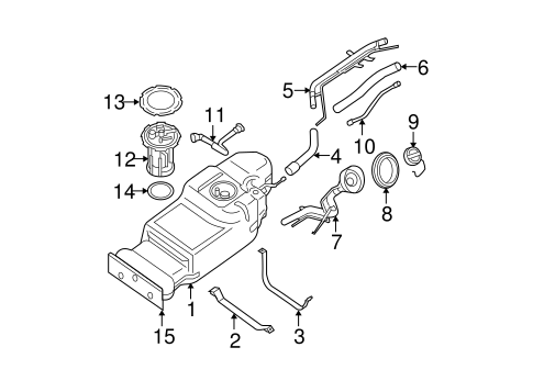

I know some fuel tanks have anti siphon mechanisms not sure about the
xterra but being there is not locking gas door maybe.
You could try to find a way to use the fuel pump to get most out but it would be under high pressure and you would have to be careful.
Another possibility can you remove the filled tube near the tank and use your siphon device?
Also here is a picture that is a tough bend to get around on number 7.
